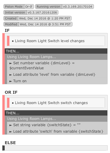

I’ve used this setup in CoRE for that. It mostly works but is very laggy. A hold down action actually doesn’t work very well. The lights will temporarily turn off and then come back on. Darwin explained why that happens once but I can’t remember where, something about a firmware glitch.
I’d love to know if someone has a better CoRE strategy to make this work better.

The problem with CoRE is … what can I do to recognize a single up when the switch is already on or a single down when it’s already off.
CoRE will see the event but there is no state change. I have these to choose from but haven’t found one that works: (changed, did not change, is, is not, is not one of, is one of, was, was not, changes, changes away from, changes away from one of, changes to, changes to one of, stays, stays away from)
