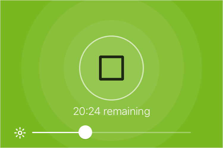

  1. A Controller!
  • I created a DeviceType to control Gentle Wake Up. It will be created automatically when you install/update your app. To update your existing app, just open the settings screen for Gentle Wake Up and hit the Done button.
  • You can start and stop the dimming cycle by tapping the controller tile as if it were a switch… because it is a switch! And the fact that it’s a switch means you can start and/or stop Gentle Wake Up with any other SmartApp that can control a switch. Say you wanted Gentle Wake Up to start at a certain time, but only when in a specific mode. You could do that with a Routine, with Smart Lights, or practically any switch-controlling SmartApp. This opens up incredibly flexible control. Honestly, I’ve stopped using the automation and completion rules that are built in to Gentle Wake Up because I can do the same things and more with other SmartApps.
  • You can jump to any point in the dimming cycle, by moving the slider! Say you have Gentle Wake Up dimming down as you fall asleep, but the book you’re reading is just too good and you want to read another chapter. Now you can easily jump backward in the dimming cycle to give yourself a little more time before your lights shut off. Or if you’re super tired and want to jump forward a bit; not a problem.
  • I also hear there’s some sort of Rule Machine floating around. I bet there’s some really cool things it can do with this new controller :wink:
