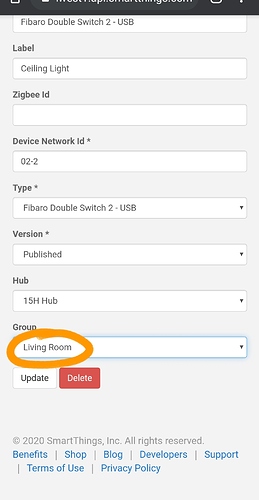

Hi Fab, try adding the devices to one of your rooms in the ‘Group’ setting in IDE. Then edit which switches you want to show in the new app.
If anyone was wondering, I finally got it to work by re-addding the device again in the new app and then following the above instructions to 1. delete the child device; 2. change the parent device to “Fibaro Double Switch 2 ZW5” handler
Hi, I tried to edit the group in the USB child device in IDE but still it doesn’t show anywhere in the smartthungs app
Its there in IDE but not in the app !
So you changed the group and still didnt see it in smartthings app?
yes exactly. changed the group in IDE, but nothing appears in the app. the device is not there in any of the rooms

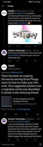

Also here is a conversation between me and fibaro:
