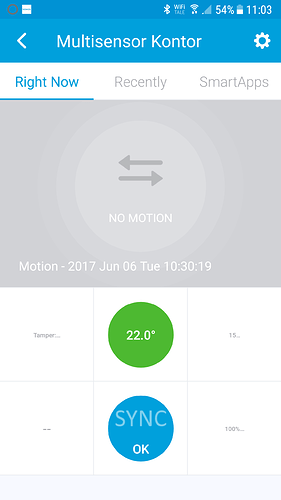

@ClassicGOD This DTH does not render very well on the new Android 2.4 version.
Putting a space before the \n in the tiles works for me :smile:: Edit: at lines 48, 63, 66
Which line of the code are you referring to in the DH? I’ve looked and can’t find a \n to update. Any guidance would be appreciated…
Lines 48, 63, 66 :stuck_out_tongue:
I’s an bug in SmartThings app, why it’s not fixed yet I have no idea.

The UI on my phone is somehow showing smaller font.
Have a look at this link here and the question just above… Solved my UI with simple update to the code: [RELEASE] Fibaro Motion Sensor ZW5 (ver. 3.2) (Advanced DTH)
@BlackCatPeanut Thanks. That worked well.
