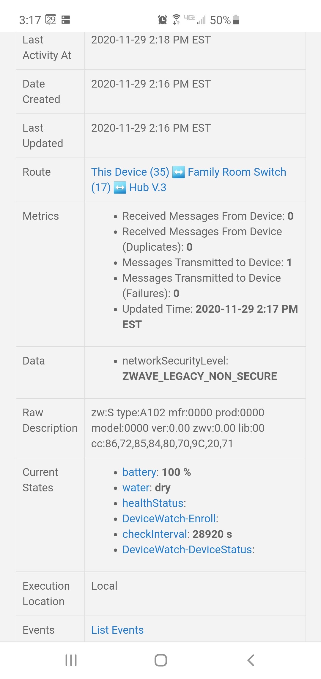

Just added 2 today. This is how it looks on mine. I had the cloud with the line through it until I tested the sensors. I am using the stock Everspring Flood Sensor. I got mine used and had to exclude before adding. I also had to close both lids before it worked.
Very strange. The only real difference I see in the screenshots are in the metrics transmitted section. Mine is showing:
- Received Messages From Device: 0
- Received Messages From Device (Duplicates): 0
**Messages Transmitted to Device: 1
**Messages Transmitted to Device (Failures): 1 - Updated Time: 2020-11-29 3:38 PM EST
