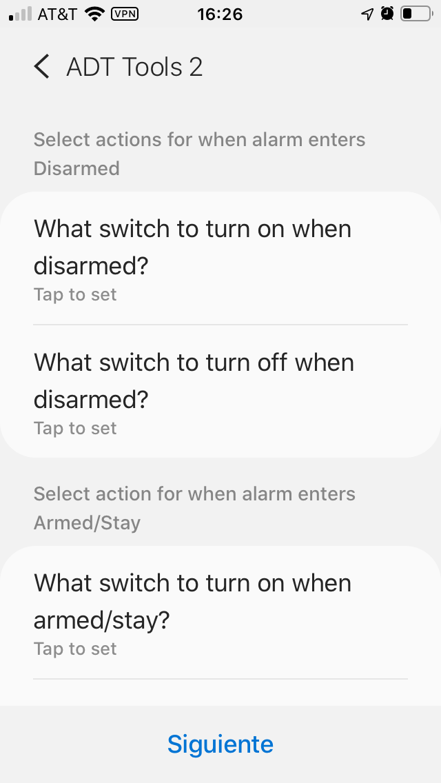

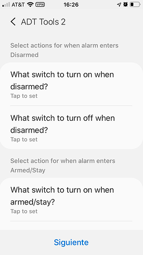

Hi thanks, me too, and virtual buttons are working great, my question is about how to know the current alarm panel status in order to automate or make some rules in 3th party dashboards like Action Tiles or Sharp Tools ?. I can trigger Arm/Disarm with buttons, but when someone arm/disarm directly in the touch screen everything lost its sync…
It is updated as those parameters for those commands should be (true) and not armedStay or armedAway. If that is working now then Smartthings corrected what they broke.
Unfortunately no there isn’t a way to do that. you could use different switches and have ADT Tools turn on and off switches based on what state is valid, but that is about it. Keep in mind you are also subject to what those external apps support. In Action tiles case even if someone created a hub device that exposes the status it would need to be able to interpret it. They have been pretty clear they don’t want to do it since official support isn’t really there from Smartthings.
It also looks like Action tiles actually killed the SHM. The Location Alarm Status attribute is still valid and available. ADT Tools even updates it still if it is set.
Thanks dear @Mavrrick58, I just remembered this part about switching on/off a device when arm/disarm, so I can use it to on/off virtual switches that indicates the panel status ? Is that what do you mean my friend ?! If that so, then I can create a rule that switches off the other 2 switches when correspondent switch is on because this function…
Thanks for your kindly help…
That is the idea exactly.
Working Perfectly !!!.. Thanks a lot
