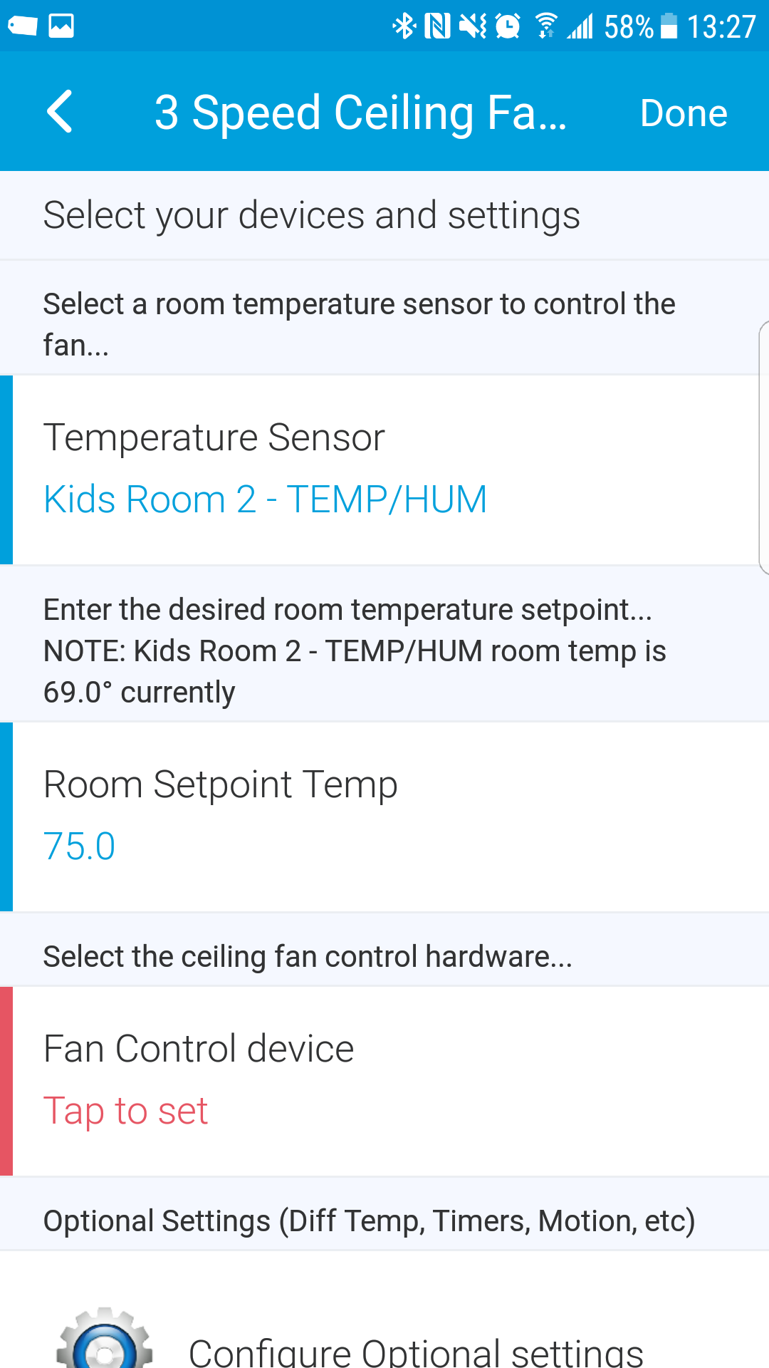

Hi I cant see my fan when I click on “Fan Control Device”.
I have MR101Z.
I use DTH from https://community.smartthings.com/t/beta-zigbee-ceiling-fan-light-controller/85084
I have MR101Z.
Currently this app is only compatible using the device handler such as Z-Wave Smart Fan Control Custom Device Handler on a GE 12730 Z-Wave Smart Fan Control or Leviton VRF01-1LX designed specifically for motor control.
So it won’t work with your existing hardware but it will be rewritten to work with this new Zigbee fan controller and device handler. The Zigbee controller is still in Beta so I’m waiting to make sure any device handler changes during the alpha/beta stages won’t adversely affect this smartapp operation.
Click here to get the Beta “4 Speed Ceiling Fan Thermostat - Zigbee” version of this smartapp that works with the new Zigbee MR101Z device. I am currently testing it on two ceiling fans and it is stable.
For the final release I am trying to get the smartapp to recognize whether you are using the Zwave OR the Zigbee device automatically so you don’t have to have choose which is the correct smartapp.
