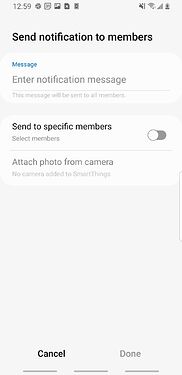

@nayelyz is there any plan to implement an ability for an actual notification via app in the Rules API? The Rules creation in the app allows creating notifications even to specific users but this capability is missing from the Rules API. So, the Rules API has more extensive capability than creating Rules in the app but is also limited. Seems like anything you can do in the app should be available in the API. Perhaps we need an ‘app’ device that we can command?

This has been mentioned before by other developers. However, there isn’t an option to send notifications. I’ll ask the team again to know if there’s any update.

You can send notifications using the Routines tool, or, are you using only the API/Rules API?
I attempted to use a routine but there was not enough control over the trigger and the notification was only sent to my phone, not my TV. I will attempt to use the API. Can you link the documentation please. Thank you!
I was just asking because sending notifications from the Rules API isn’t currently available. I’m discussing this with the engineering team.
Also, AFAIK, notifications are only present in the mobile app. I don’t have any more information about notifications on the TV. In that case, you should contact SmartThings Customer Support to know if it’s possible using the Routines tool.

Create a virtual switch, turn it on in rules API and create a routine in the app “if switch is on, notify”.
Hi, @nileshlande12. Welcome to the SmartThings Community!
Sending push notifications isn’t supported through the Rules API. So, the suggestion from @mocelet is a good alternative.
