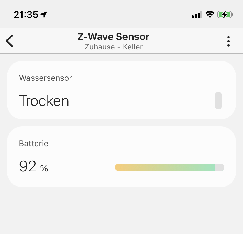

I read something that I can change it to a switch to run a rule, but would like to try other action.
I use the new smartthings app and the device is an
Abus Waterleak sensor. Unfortunately I can t find this product as an supporter device but it was easy to connect also to find a topic about that Produkt isn’t that easy
I just need a small advice how to create a rule, that when the sensor turn to wet to geht a notice like text message or email or activate another thing.
Thank you in advance
Marc

Thanks for reply, actually it was recongnised as an water leak sensor. But may be that’s the problem to handle with this device handler and IDE, I still didn’t get it. so thanks for the instruction I will have a look now right now
It s not working for me. can t find device handler for this product. And its already recognised as a water leak sensor.
I only found device handlers for other brands, so i need to find another solution
