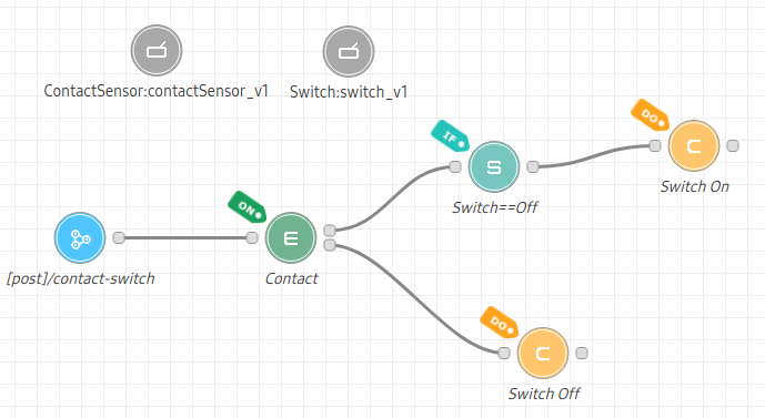

Ok… I finally was able to use the official node ā€œAutomationā€ from node-red-contrib-samsung-automation-studio-nodes.
I had to import the template ā€œSmartThings : Automationā€ from Samsung Automation Studio.
Template "SmartThings : Automation"
I also had to read the source code to understand Automation can only connect with a single Event Device and nothing more, not even Debug.
