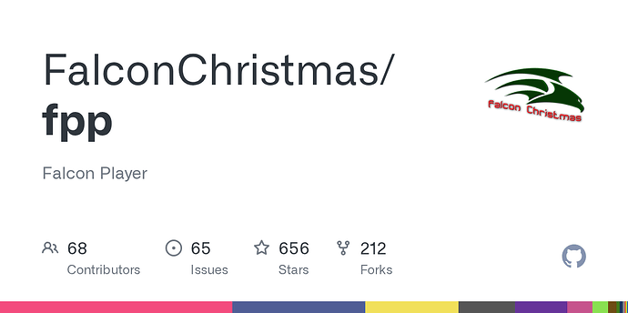

Also, I’m not sure any of these links would help you but this is what I’m trying to work with:
I got to doing some reading on the above and it looks like the offer something called curl. Below is a code example.
