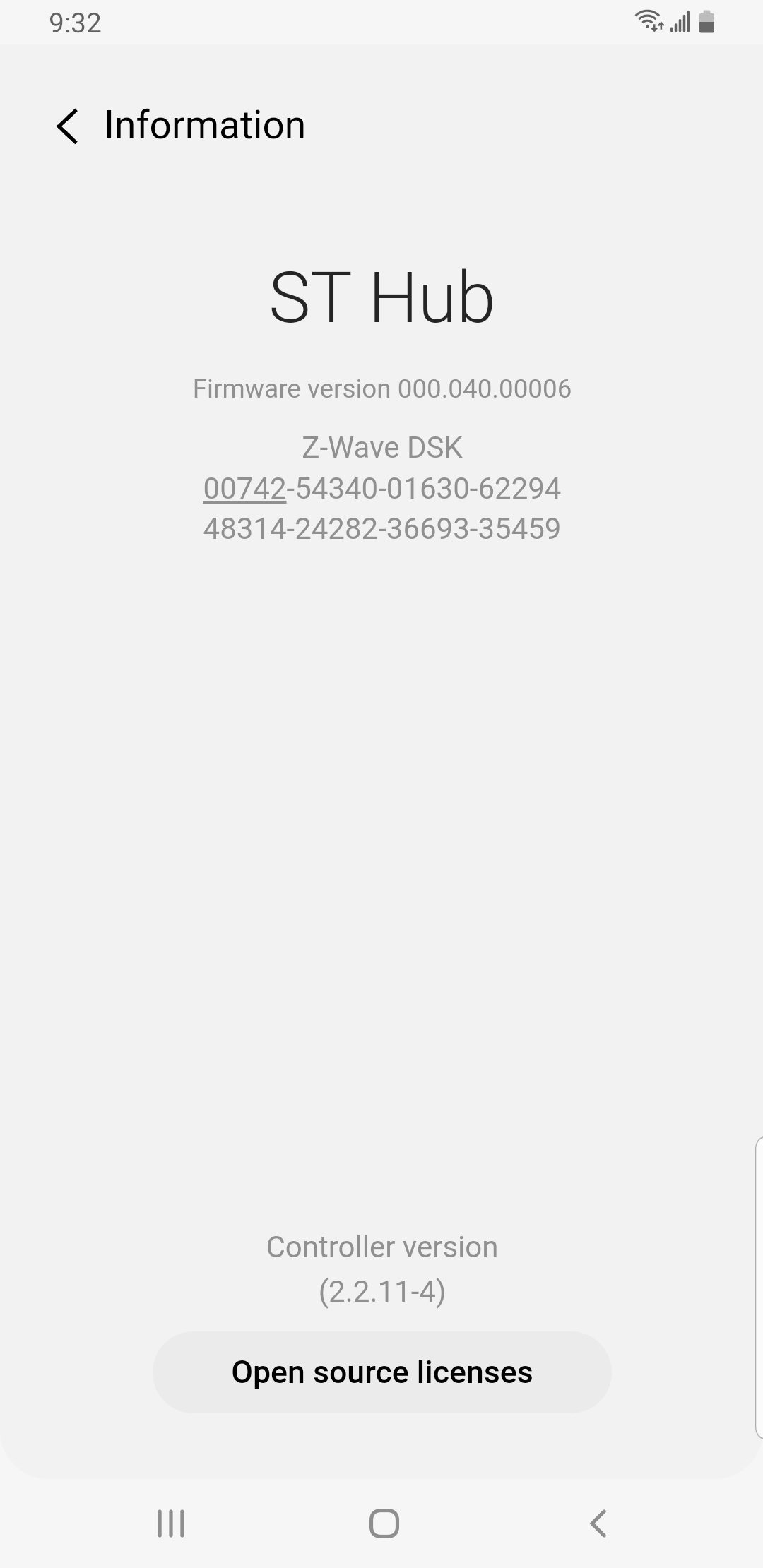

Also, do you have a smartthings hub, and if so, which model?
Oh, and it is technically easier to do this with a dimmer rather than an on/off switch, so regardless of where you live you will have more choices in that category.
That doesn’t tell us the hub model number.
Look on the bottom, there should be a label with it. Don’t post the serial number, just the model number.
Anyway, since you do have a hub, and you’re in the US, here are a couple of choices:
