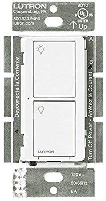

How about this Lutron Caseta Switch? No neutral required. :wink:
https://www.amazon.com/Lutron-PD-5WS-DV-WH-Wireless-Wall-Switch/dp/B00NO7Z80S
Good point, although it requires an additional bypass device to control LEDs.
http://www.lutron.com/TechnicalDocumentLibrary/369831_ENG.pdf
But yeah: Lutron is often the exception. I still suspect their story is a “man who fell to earth“ scenario. :alien:

The odd thing is when I search for Caseta switches the prices are around the $50 range. Is this a different switch?

Yes, this is a special ‘no neutral required’ Caseta switch. As @JDRoberts pointed out earlier, these are a bit of a ‘white whale’ in the home automation world.
As for the price, yes it is a bit steep. I didn’t ‘shop around’ when I posted the link. Perhaps you could find it slightly less elsewhere?
