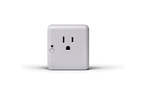

The Lowe’s iris brand makes a pocket socket which is very unusual in that it can repeat for both zigbee and Zwave. This makes it a convenient choice as a repeater. You can buy it from either Amazon or Lowe’s, but since it’s often on sale at Lowe’s I think most people buy it there.
