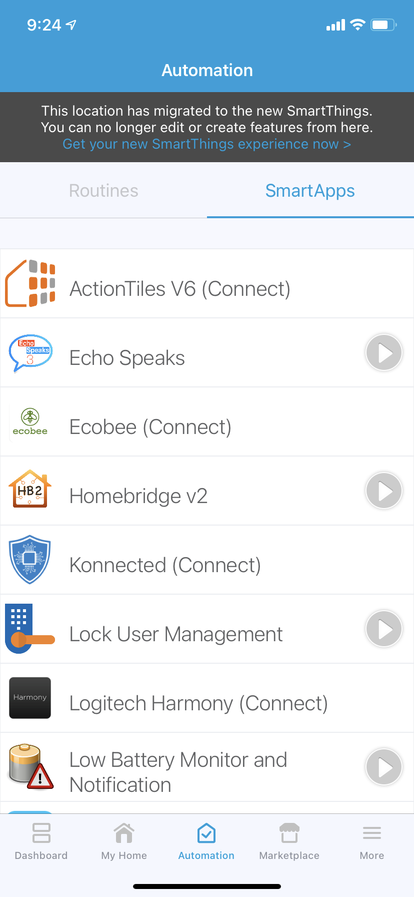

I have no smartapps. I can’t authorize new items in webcore. I can’t add things to actiontiles. Not sure what else I cannot do but I am sure the list will grow.

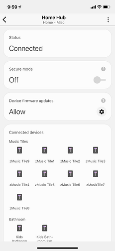

Does your hub show in the new app > menu > devices?
Yes it does.

Those apps which are linked services do show up in the place you describe. Interesting Action tiles is a linked service but I have no way to authorize new devices.

But again, some of those old Smartapps have been moved to menu > settings > linked services

And again, many of those have been moved to menu > settings > linked services
