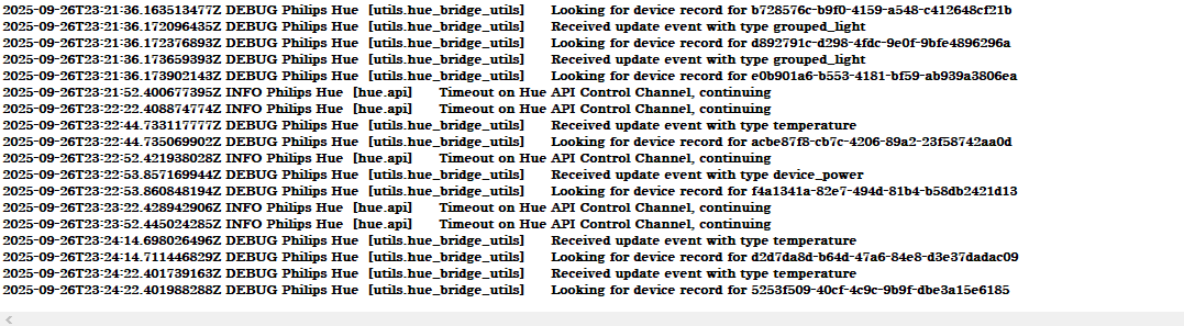

Tap dial switch hue, Bedroom switch 2 hue, Bedroom switch 1 hue, it’s also the all of the other dimmer switches but I decided to go with one of each type. (The hue dimmer v1 and a v2 plus tap dial switch)
I’m not sure if I should have done all of those. I did ask for thy hub logs but I don’t seem to have got anything. But I took some screenshots of what came out of the cli after I pressed the buttons. So it seems to notice the button was pressed. Although in the device page it doesn’t say it was and any actions don’t happen.
Sorry if I’ve done this all wrong.
I tried a reboot on your suggestion but it seems to be the same.
