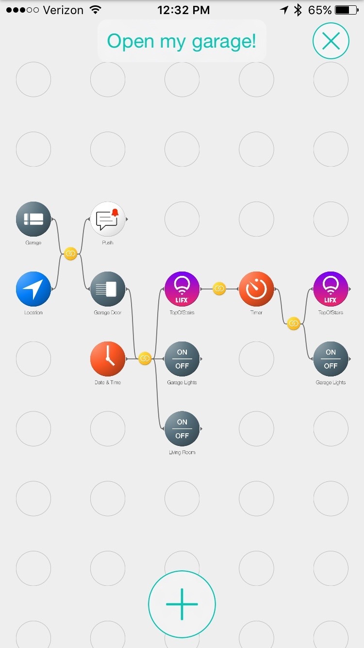

We allow multiple triggers and actions as well as cascading flows. “If motion is detected AND it’s between 8:00 and 10:00, THEN turn on my light, THEN once my light has been turned on, send me a push notification.”
If two triggers go into the same yellow “quicklink” before it reaches an action, it’s treated as an AND. If you drag two triggers directly to an action, it’s considered an OR.

Here’s an example of my “Open my garage” flow including iOS location, SmartThings, push notifications, and LIFX:

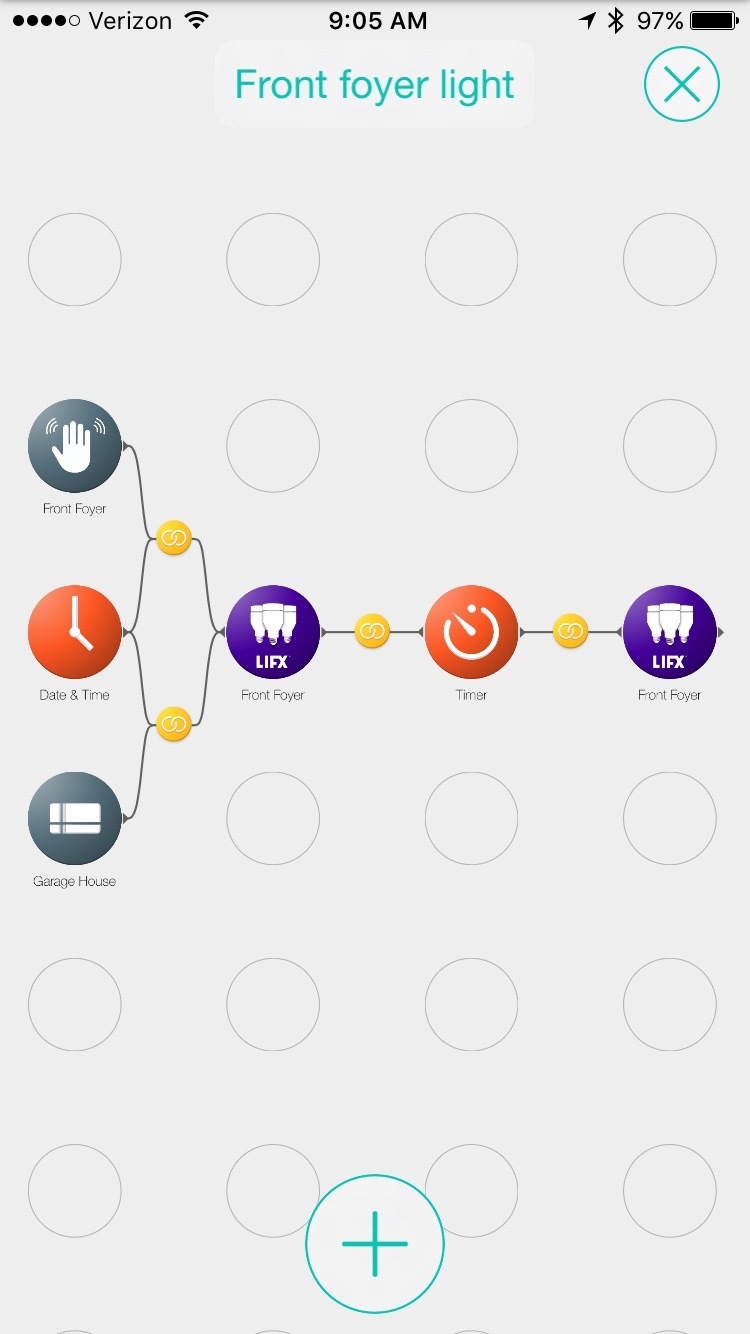

"When it’s after 6PM AND my SmartSense motion detects motion… OR When it’s after 6PM and my House Garage door opens, turn on my LIFX “front foyer” group (which includes 2 lights), wait 30 seconds, then fade my LIFX off over 1 minute:
