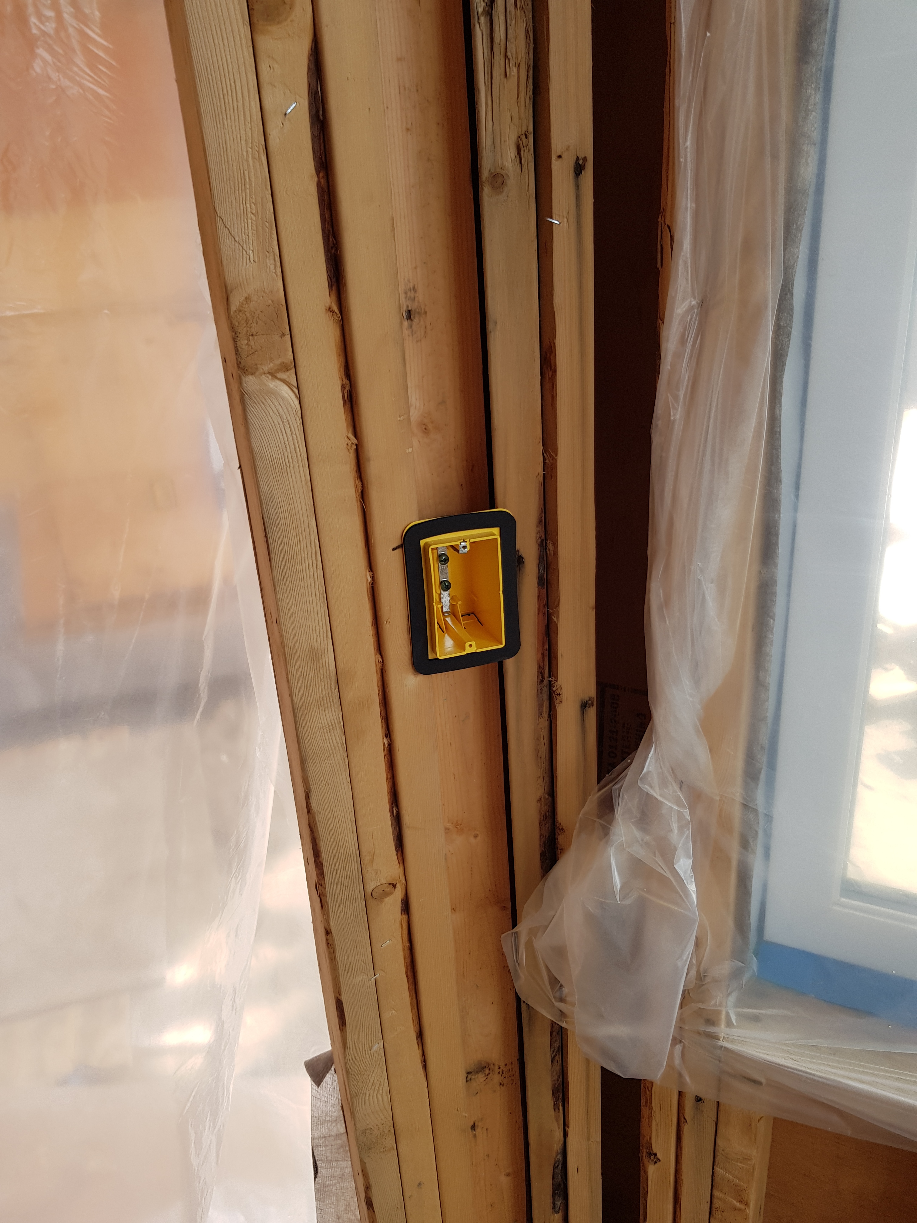

To the left we have an exterior door and to the right we have a turn in the wall and a window. In this corner there is only width to put one gang box. But ideally, we should here control sets of interior and exterior lights.
So, the options we are considering are:
Stack gang boxes (as you bring up)
Put actually switches elsewhere and a smart multi-button control here that controls them via a hub.
Use a micro to allow control of the lights by the hub without a physical switch, and use a multi-button here to control the lights via hub.
