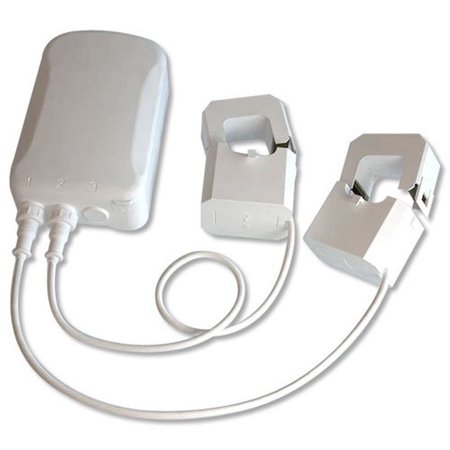

How do you know if it’s v2? I’m looking at this one…
Aeon HEM V2/Gen 2 has an AC plug, doesn’t run on batteries…

This may be a stupid question, but what is the repository name so I can integrate it into smartthings?
As I noted earlier, I am not actively managing this device anymore. It was developed before the SmartThings GitHub integration, and as such is not structured to be integrated into smartthings. Just the good old copy/paste approach, I’m afraid. But it isn’t changing any more, at least not until SmartThings fixes the things that are broken in the UI (font sizes used to scale, now they don’t; things work very differently on Android and iOS, etc.).
Ok, thanks for the quick reply. I searched this discussion but did not find that. It seems to be working well enough. I am using an android phone. At least with your handler I can see usage from each leg.
