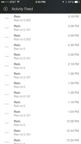

Brian, remember you still have access to my weather info from Netatmo. It’s raining now. My activity continually shows 0mm, and the activity has activity, but always zeros out to 0.

I poured more volume down my rain gauge today. It showed up in STs. I think rounding is the issue. When i got the mm mesurement above .5 it put 1mm into the data tile.
When it was below .5 it still showed 0mm. Since rain is measured in tenths most of the time the best solutuion would be to always show two decimals places. So even when we are at zero accumulation for the day we can show it as ā€œ0.00 inā€ or we can show ā€œ-- inā€. I think this should work. Can this be done @Dianoga?
Also, the next time the data was read from netatmo it zeroed itself out. Similar to what @krv is seeing.

I have updated code that will include past hour and past day measurements. Also, it will allow choosing inches vs millimeters. I haven’t submitted it yet as the tiles will almost never show anything other than 0 (especially if you prefer inches). I sent a couple of questions to my contacts as SmartThings to see if there are better options out there.
Does STs force rounding to no decimals? Rain should really be shown in decimals honestly. Since even 0.1mm means an additonal 100,000 litres in volume of rain has fallen over a kilometer the difference between 1mm and 0.1 mm of rain is 900,000 litres, or for us non metric peeps… 237,754.847 gallons.
In rain fall the decimal is very important. lol :smile:
Not sure if this is the case on iOS, but the updated Android app is showing decimal values. Does anyone else see that?

I was just able to verify that rain is showing decimals. The updates have been submitted for publishing.
