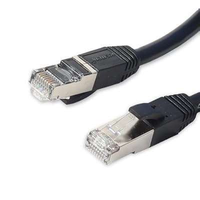

I use all cat7 because it is flat and shielded. Hardly couple of dollars more.
Tons of these in various lengths and colors
BUT THE FLAT VERSION OF THE ONE SHOWN IN THE LINK. ALSO AVAILABLE AT AMAZON. And I don’t mix and match 6 & 7’s. Only 7’s.
