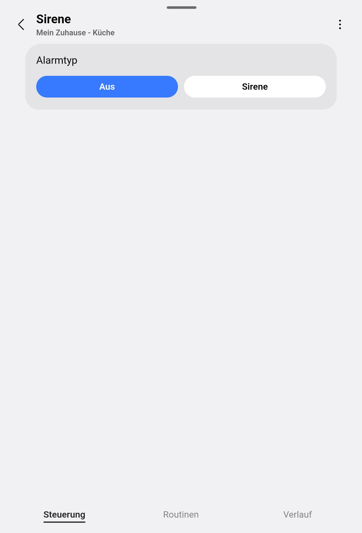

How do you trigger them?
They are just the usual siren devices in ST:
