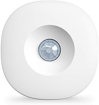

The outdoor caveat for motion sensors may raise the price quite a bit. I might suggest just protecting the motion sensor from the elements if possible. Like pointing it out a window or placing it under an eve or something. Any zwave or zigbee motion sensor is compatible with the ST platform and will work for your situation.
Any way, a ST hub, a ST compatible motion sensor, and a ST compatible in-wall switch will do what you’re asking. The automation part is included in the SmartThings(ST) phone app, called smart lighting. You can easily setup; turn on [switch] when [motion sensor] motion is [active], and turn off [switch] when [motion sensor] is inactive for xx minutes.

Matt has covered most of it. But I’m not sure the Samsung motion detector will survive well outdoors, it depends on how exposed to the elements it is.
FWIW, there is a Zooz brand motion sensor intended for outdoors. I’ve purchased several Zooz switches and dimmers and been very happy with them
http://www.getzooz.com/zooz-zse29-outdoor-motion-sensor.html
