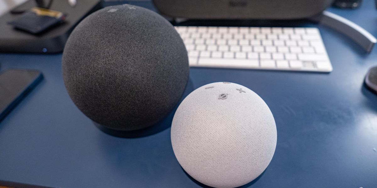

I was unable to get the 4th gen Echo Dot to discover a Hue Outdoor Motion sensor (zigbee) but was able to connect it to SmartThings gen 3 hub successfully using an Edge driver.
Only some Echo models have a Zigbee hub inside. As far as I know, none of the dot models do, and specifically the fourth generation Echo Dot does not. :thinking:
Note that the “echo fourth generation“ is a different device than the “echo dot fourth generation,“ which may be where the confusion was.
The following Echo devices have built-in smart home hubs that seamlessly connect and control Zigbee smart devices:
Echo 4th Generation
Echo Plus
Echo Show 10 (all models except 1stGeneration)
Echo Studio
Zigbee hub yes:
Zigbee hub no:
Both are good devices, but the larger one does have some additional features, including the Zigbee hub inside.
I was completely unaware of the difference. I see now that it is a larger size plus more speakers in the zigbee enabled one. That explains why the sensor wasn’t found. Thank you!
