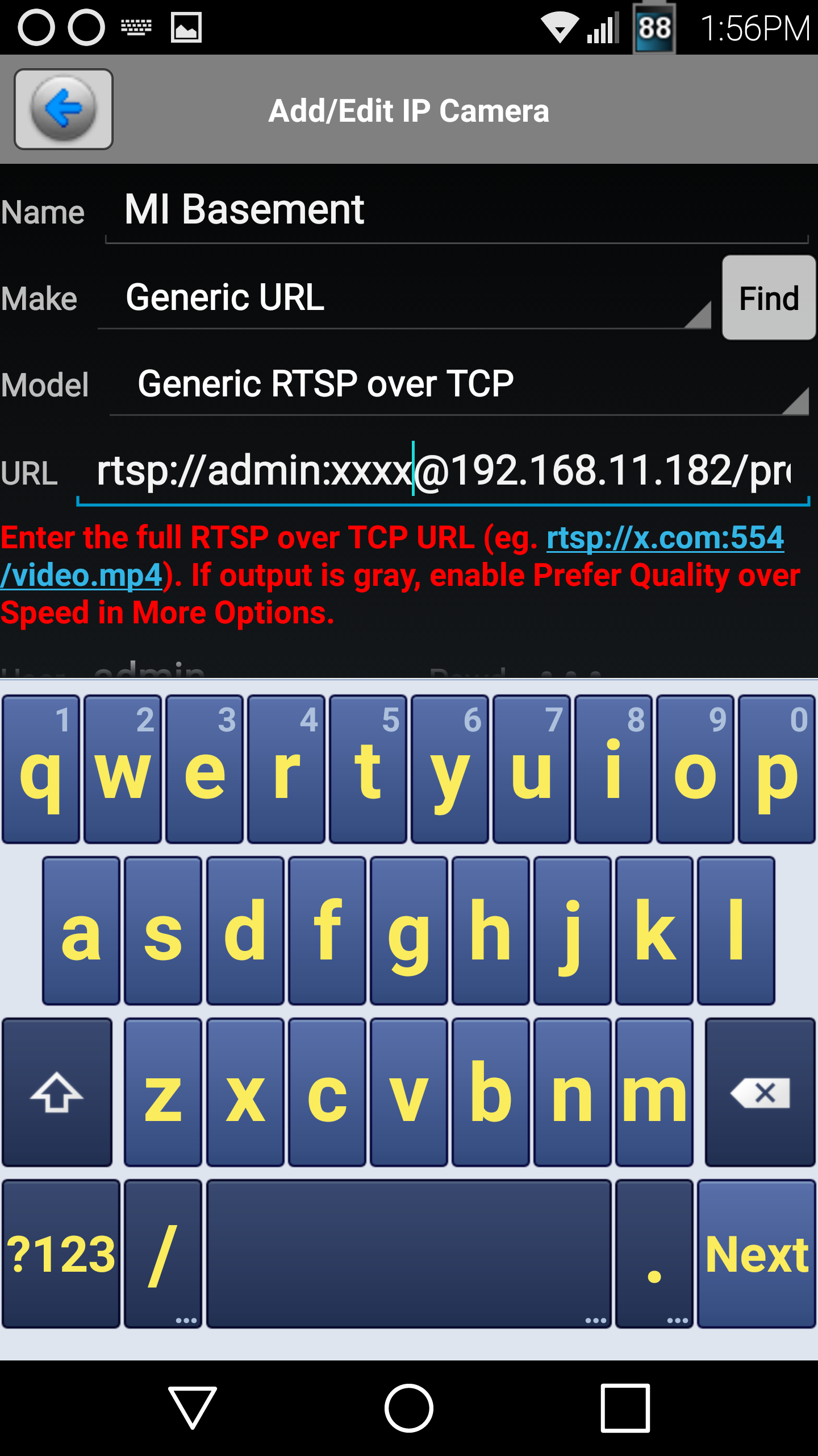

you can use rtsp with custom device type with “ip cam viewer basic” I believe you will still have to create a samsung smartcam account and initially have internet to set up the camera…
Once you know the local ip, you can put that into the ip cam viewer with rtsp url and then use locally or when away as long as you have a vpn to let you get into your local network.

why can it not be used… if it runs locally it is not going out on the net and no fireweall would block it unless you have a firewall even for the local net. it is rtsp running over tcp so all local
. ie here is my rtsp url

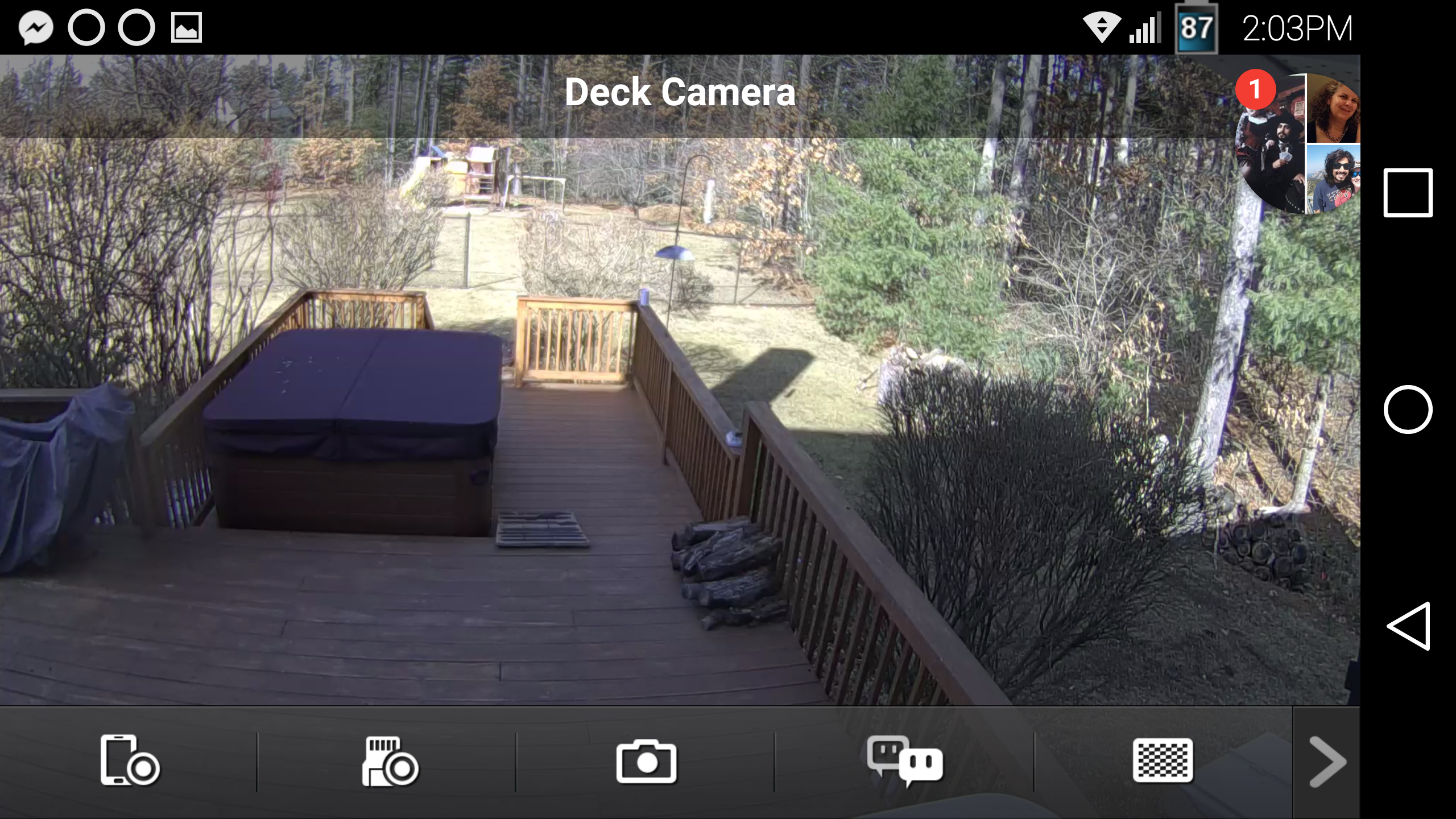

any yes the smartcam app can work from anywhere. works well. the biggest issues are

view of a camera from samsung smartcam app
after login screen with samsung smartcam app
