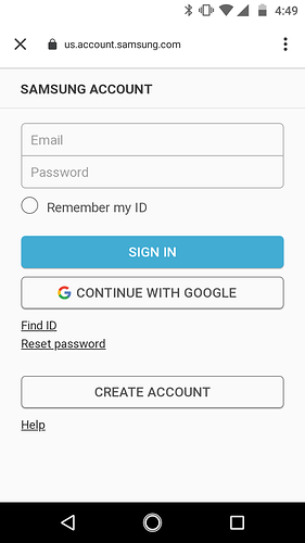

So I am trying to create an Android app that can integrate multiple Smart Home apps together for analytics. However the only way to obtain information about people’s devices is through a personal access token. Taking a look at the Samsung Connect app, when you login, you see a screen like this:
I assume that after login, the app returns the user’s personal access token in order to retrieve the list of devices, correct? If this is the case, how can I register my app with this “Login with Samsung” to set up all the app client id, secret, callback url for my app?
