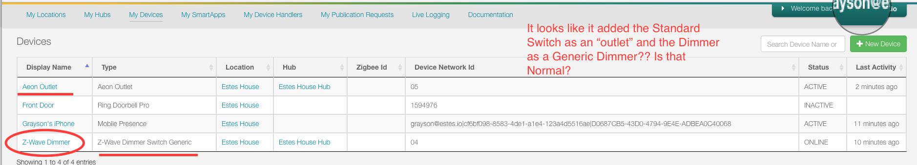

I have purchased both the Aeotec Z-Wave Micro Dimmer, 2nd Edition (DSC270103-ZWUS) and the standard Switch (DSC18103-ZWUS). Notice in the photos attached what it looks like when simply adding them as a “thing”.
I did the standard binding protocol and alghoh they are bound the slider for the dimmer seems to nothing. It acts only as an on/ off switch? I have tried this with 3 different ones. Is there a different way of pairing them or a separate module I should be using?
I’d love to figure out if I need to add these a different way to get them stable. I plan to have a lot of them in my house and don’t really want to have to mess with taking faceplates off every time theres an issue. Its reassuring to hear you’ve have good luck with them.
