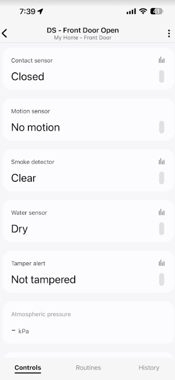

I guess it is working but has a lot of other data on it such as water sensor, smoke detector…. No way to change it to just an open/close sensor.
I don’t have the driver installed and don’t see an option for one.
Did you try Milan’s driver mentioned above?

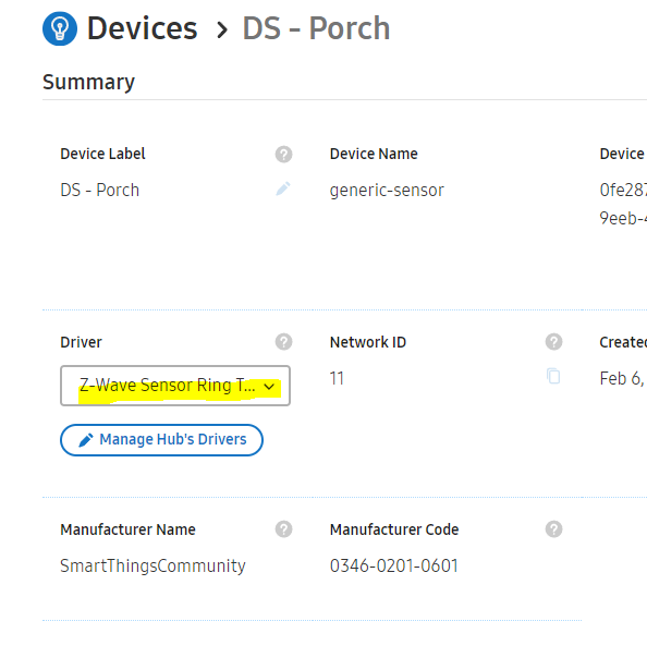

Try to pair again or just change drivers until they show or update all fileds. I know that my driver works fine. Tested.
My Ring Gen2 sensors picked up the Z-Wave Sensor CS driver since I had it installed for some Ecolink and Aeotec sensors. It works flawlessly with the Ring sensors as well.

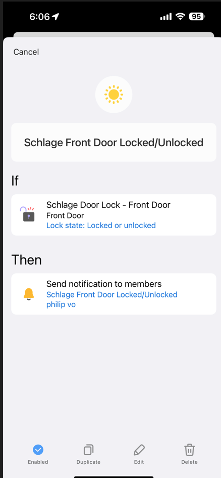

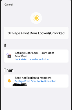

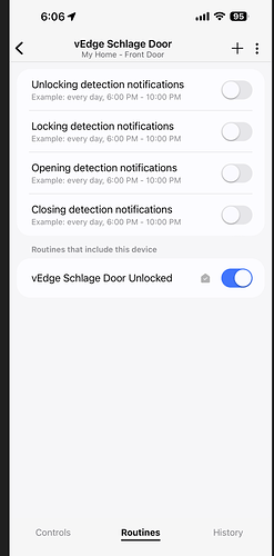

I got that one too. Let me shot you some screenshots for smartthings settings plus vEdge settings below. Can you take a quick look to see if you see anything unusual.
