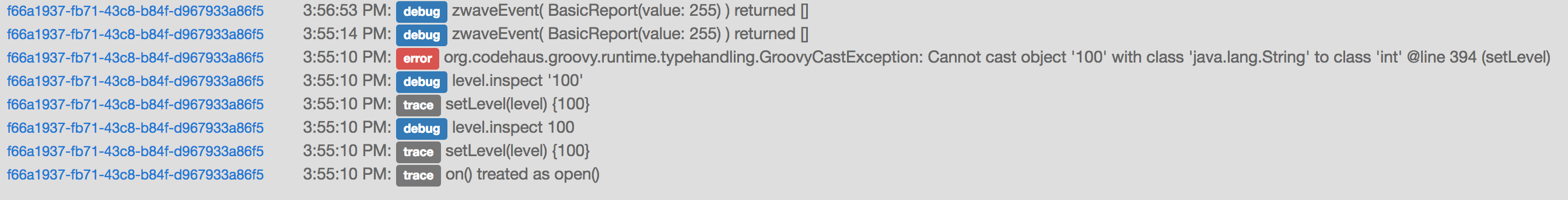

While leveraging your somfy-shades DH, I see errors in the outputs and inconsistency in actions and acknowldegement. More specifically, I have a routine that simply opens 3 shades. when this command is submitted, here is the output I see while logging on just one of the shades. I see these examples acrossed all of them:
I am using the somfy ZRSTI II with 3 day rolling shades. I did not have any issues with this setup against my homeseer controller, but having serious inconsistency and errors as noted in attached. Additionally, the close tile does not work but rather the preset/stop allows me to close the blinds. Please help.
I am running the exact DH from imnotbob repository.

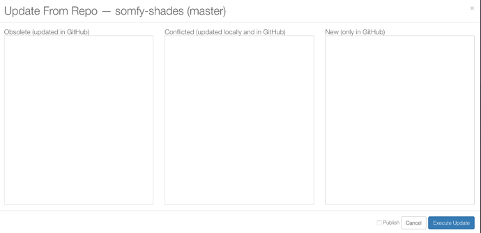

I’m having an issue adding your repo to the smart things website. For whatever reason it’s not pulling in information. Any ideas? Sorry if this is a stupid question in advance :slight_smile:
I don’t think that github repo has the required layout to make it consumable in SmartThings. You basically have to copy and paste the groovy code manually.
