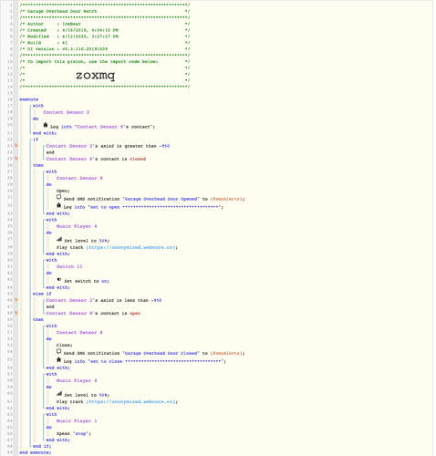

I then converted it to garage mode, and created a piston based on the z-axis changing tracking current state with a virtual contact sensor (attached). Things were good for a few days, but then it triggered. When it triggers, it goes to about -942 on the Z-axis, which is odd because all my tests, that was a significant angle, which the door wouldnt sway to with wind/shake.

Its overkill, but, maybe I will set up two and have them both need to hit the tilt tolerance. False positives suck.

Ive been having good luck so far with the dual sensor combo on the door – but then again, watching the log, Ive only have one of the sensors drop below my threshold (-950 Z) which is still odd since that angle during tests seemed to be far greater than any ambient movement of the garage would be

I learned that my WebCore was out of date (missing some new modules, but running current release). Ive since updated, Im am not sure if this could of also been an issue. I havent had a false positive since I added the redundant sensors.
