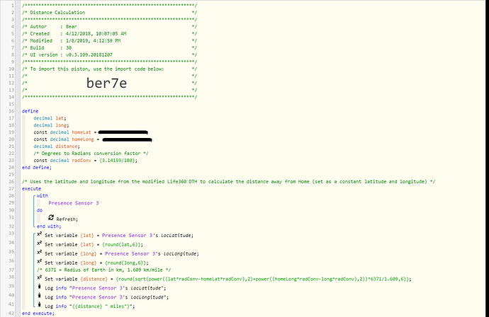

At one point I was using the free Life360 (iOS) and modified a version of the Life360 User DTH by tmleafs to also return the latitude and longitude from the generatePresenceEvent function. Never finished working on it (stopped when I saw WebCore Presence get released), but once you have those it’s a “simple” math problem to determine distance from another geographic point.
