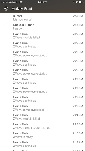

I think this explains it. I got the message after multiple power cycling, attempted removing items, and noticing that my locks weren’t unlocking any more. I’m guessing this falls under warranty?

So after the picture above I contacted ST and have had to unplug it and wait x minutes for two days. Friday I emailed them to begin the replacement process and I guess they are off on Fridays. Kind of disappointed at the response to something that I have come to rely on. It will be interesting how they fare after the apple home kit is released in June.

Did that, check out the screenshot I posted. Seems the z-wave module died on me. Happy to report that they are expediting me a new unit. Wish there was a way to save settings and transfer them to the new unit. Oh well, it will give me something to do this weekend.
