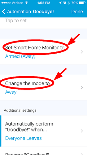

I have been trying to get the “Goodbye” and “I’m Back” routines to work. Eventually I got it but there’s something here that makes no sense to me.
First thing I did was to edit the settings for “Goodbye!” by clicking on the gear-icon in the Automation dialog.
Then, I see that there’s TWO different items that look like they need attention:
Here’s where it gets confusing. “Smart Home Monitor” and “Mode” have very similar options. I had been setting “Mode” to “Away” thinking that it would make “GoodBye!” have the same effect as pressing “Armed (Away)” on the main screen-- but that was not the case.
So now the question is… I have two settings that I can change for my routine: “Smart Home Monitor” and “Mode” – why is that? Why would they EVER be different from each other?
You’re right, the terms can be confusing and very unintuitive for new users. but there are actually very good reasons to have “modes” that have nothing to do with the alarm “state” of SHM. See the linked topic below.
There’re many reasons why location modes are different than SHM modes, but none of them is particularly good one.
The FAQ problem explains all, but lemme try:
  • SHM “mode” should never be called “mode”. I don’t even like calling it “SHM State”, since “state” could imply knowing whether or not an undismissed alarm currently exists. So I call it “SHM Armed Status”. SHM Armed Status is supposed to only be used by the SHM Solution SmartApp… i.e., not by arbitrary SmartApps or CoRE.
  • Location Mode (generally just called “Mode”) pre-dates SHM by quite a lot. Mode can be used by any SmartApp to affect it’s operations. In fact, if a SmartApp is using only a single preferences page, the option to have the SmartApp restricted to certain Modes automatically appears. It turns out that SmartApps can also read the “SHM Armed Status” – but that API call is unofficial and could be deprecated or disabled by SmartThings at any time. For that reason, it may be a good idea to have your Routines set both to a similar value. However, that wastes the potential value of using Mode for a whole lot of other purposes (e.g., instead of just “away, home, night”, you could have “vacation, test, pause, work-at-home, economy, … etc.”.
  • Though there are better SmartApps for scenes now, “Mode” can be considered a “whole home scene”. The distinct concept of a scene is, unfortunately, not built into SmartThings, so that’s why Mode was used by some customers for this purpose. For pure SmartThings (no added SmartApps), Routines and/or Smart Lighting are closer approximations of “scenes”.

Use a Routine…
  • A Routine can both set SHM and Mode.
  • Routines can be executed pretty easily from the Automation/Routine page, Android Widget, or real or virtual Switch.
Other way around. You run a routine to arm SHM and perform those other actions you want to do.

OK, I figured out why it had stopped working. I got a new phone and had to reinstall the smarthings app. When setting up the routines for “Goodbye” and “I’m Back”, I had neglected to fill-in the sections for “Automatically perform ‘GoodBye!’ when…”
When you first set it up, it just says “Everyone Leaves”. And that leads me to believe that the app has just tallied up all the people whose phones are presence sensors and that it will, by default, perform the GoodBye action when all of them are no longer present.
Well, that was not the case. I had to go in and explicitly select all the people to which this routine will apply. That’s inconsistent with the notion “Everyone Leaves” which had been set as the default.
Not sure if this is because I got a new phone. Could it be that the routine still had my old phone as the presence sensor even though my new phone had been added as my presence sensor? Who knows, I don’t care to find out.
Again, it seems to me that smartthings “works” but that the UI fails to provide reasonable cues about how the system is configured. That’s just not good for a consumer app.
