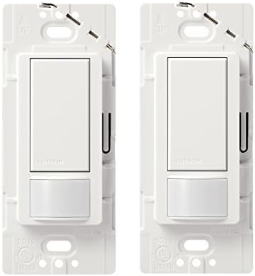

TBH, I have plenty of these in various closets…Dumb as can be but economically Smart…
On the TopGreener/Lutron devices you show it requires it be inwall IN the room you are going into. I don’t have that setup. The wall switch is OUTSIDE the pantry, so I have to use a different smart scheme…
