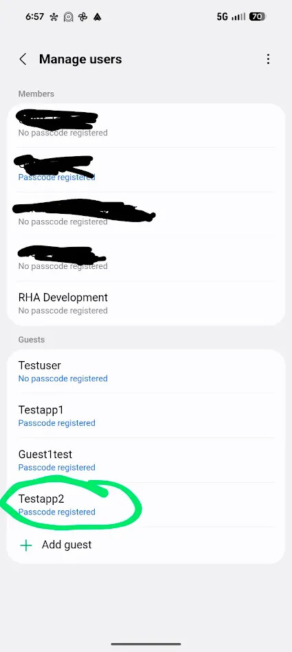

Here’s the breakdown of where I’m at with testing Matter door lock support in SmartThings:
  1. Matter locks are supported fairly well via the app itself using the “Manage Users” feature when viewing the device itself:
  2. Matter locks are not supported via the API (at least not in a usable state). See details below.
Here is the analysis I’ve been able to perform over the past week or so for you all to review.
Programming a code
The addUser and addCredential methods appear to work, but there is a lack of general support elsewhere which is required to use the methods.

View mobile “Manage Users” to confirm guest added
Mobile app does not show the user was added:

Added a guest via “Manage Users”
When adding a guest via “Manage Users,” multiple guests appeared that weren’t showing before, but the user added via the CLI still doesn’t show.
Status API refresh shows additional users
After adding 1 guest “Testapp1” from the “Manage Users,” now the Status API shows multiple additional guests, none with names:

Added another guest to “Manage Users”
To see if you have to add a user via the “Manage Users” in order for the list to refresh, I added a second user:
Status API refresh
Shows an additional user was added, but there is no name affiliated

Plugged in the code programmed via the CLI for testcli6, and the door unlocks. So even though there is no record in the Status API, there’s no record of the user in “Manage Users,” and no other way to confirm that anything worked, the code does work.
So unfortunately, while the bones are there, none of it actually works in a meaningful way that could be implemented.
