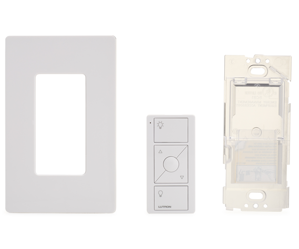

Yes, Lutrons fit in a standard switch space. The one caveat is if you have multiple-gang boxes, you will need to break off some of the heat sink tabs. They cover that in their instructions. I currently have one switch (so far) and it shares a 2-gang box with a dumb switch. I didn’t have to break the tabs off, but once that dumb switch gets replaced with a Lutron, the inner-facing tabs will have to go.
By “Lutrons” You specifically mean the Lutron pico battery operated device, right?
They do fit behind a standard cover plate and can be used in a multi gang set up alongside an existing dumb switch, but they do require a special piece behind the pico to hold it in place.
It is generally not safe to put a battery operated device inside a wall unless designed for that purpose because batteries can and do outgas. So most of the battery operated switches are intended to be surface mounted on the wall rather than inside the switch box. The ones which are different, like the pico, have a separate protective plate behind them.
( there are no heat sink tabs on the battery operated model, so you don’t have to worry about those.)
