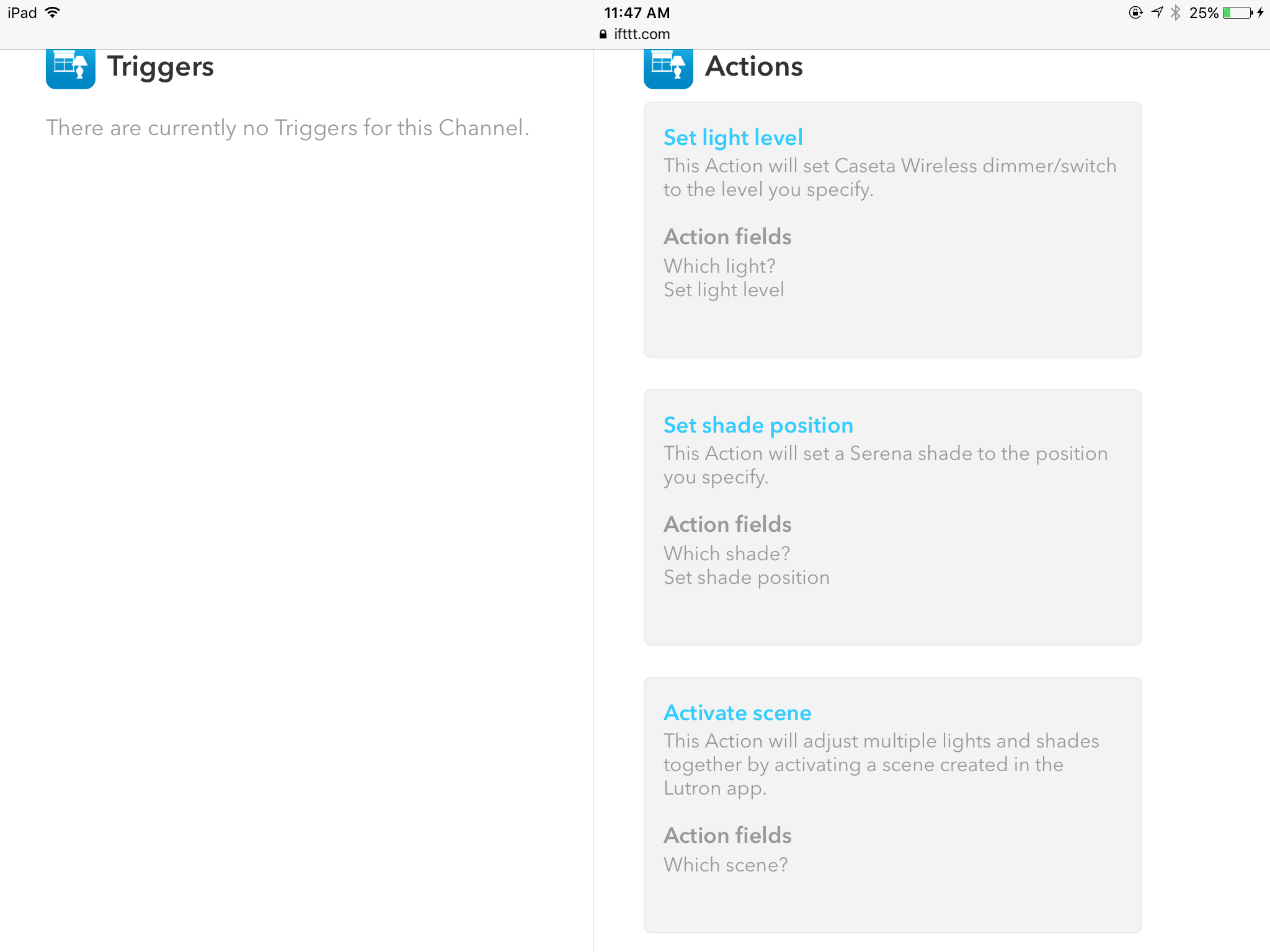

As far as the shades, you probably already know this, but you can get limited one – way integration through the IFTTT channel. That is, you can set up something on the SmartThings side that will change the shade position.
The problem is if you change the shade position with a Lutron control, including a pico remote, smartthings won’t know about it.
But you can certainly use SmartThings to automate shade activity if that helps.

One of the SmartThings engineers has already said in the forums that the pico will not be able to be used through this integration.
That’s common for a cloud to cloud integration, for example the Lutron Caseta IFTTT service/channel doesn’t recognize pico presses either. :disappointed_relieved:
