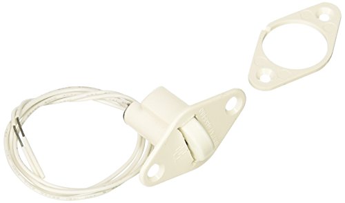

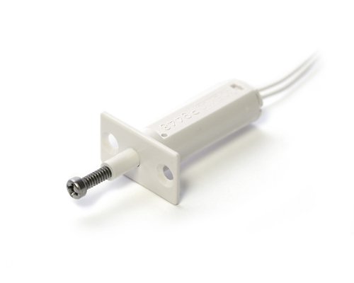

I like the idea of being able to know when the door is locked without needing to replace my deadbolt. A plunger style sensor connected to a z-wave contact sensor should work.
