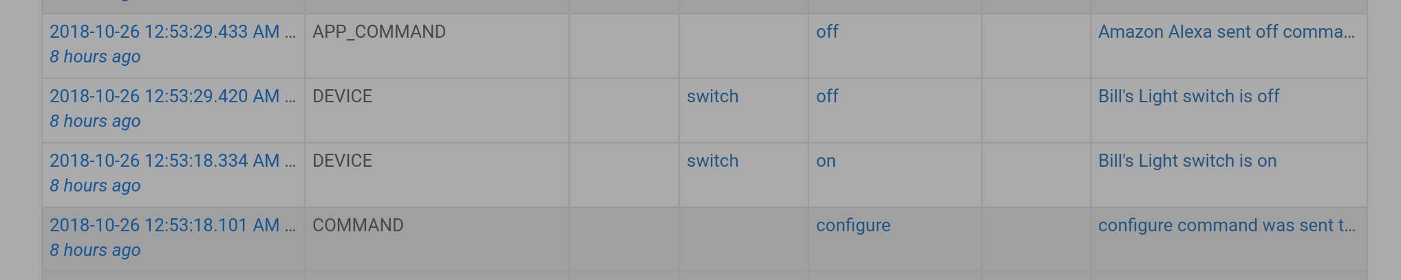

This has only started happening after I moved into my new home - never had a problem for several years at my old home. Ive noticed in the device event logs that each time it has happened a “configure” command was sent to the device.
The commands after it in the log are me manually turning it off with Alexa, but it turned on when the configure command was received (I did nothing at the time that would have caused this command).
I’ve verified this on three separate devices that randomly turn on - it’s always the “configure” command.
Hopefully this helps someone figure out what’s happening. Why is the hub sending random configure commands?
@BakaNeko59 The configure is happening after the bulb resets and comes back online. This is an indication that the bulb firmware is likely crashing which is also the reason the light turns on.
