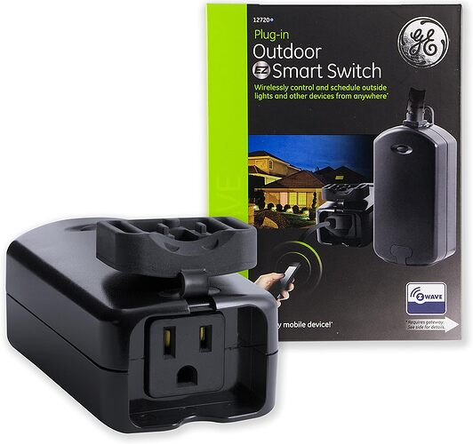

Instead, people get the GE plug-in which is designed for outdoor use and use the same kind of enclosure box with that, although you may need to get a bigger enclosure box to have room for the plug.
