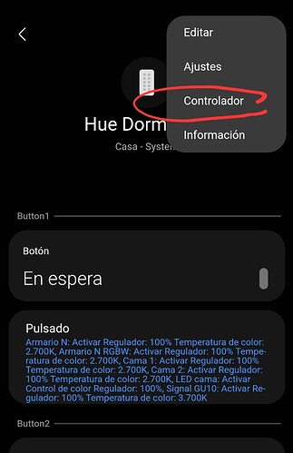

Are you sure this is EDGE? I have some of the devices in local, but they have a “driver” option in the menu in the top right corner.

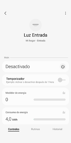

Hi @Mariano_Colmenarejo! And thanks for the driver.
It is working locally now, I can switch it on & off, but unfortunately the energy monitor is not working… :frowning:
I plugged in the hairdryer to get a quick high reading, but it’s been running for a few minutes and… nothing. It doesn’t refresh the data.
On top of that I still have some 4 kWh reading that I have no idea where it came from.

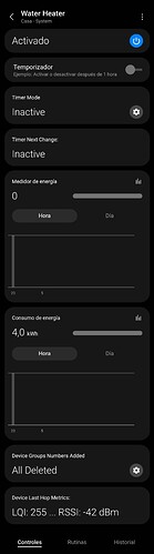

Nope… This time I have this:
EDIT: Hub rebooted after pairing.
wow strange!

After update It’s finally working! A big thank you to @Mariano_Colmenarejo, you are great! I owe you a beer or wine. Let me know if you visit Barcelona.
Hola,
They fixed something in the app so that the power and the W units would work again.
It was very strange that it reported total energy and did not show instant power
