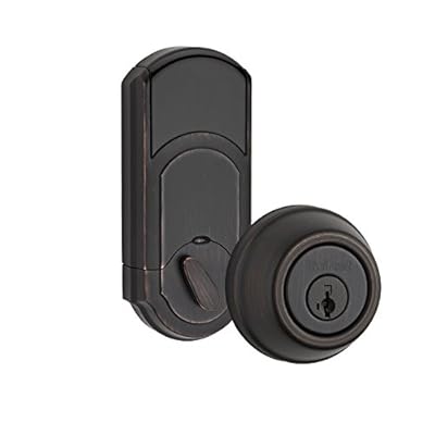

I put a 910 on an existing dumb deadbolt (rear door where no keypad required). The outside part with the key on the new 910 set did not exactly match in design/looks to what I already had so I installed just the inside part from the new 910. I left the existing latch and outside key part in place. All is good.
This is what I used …
