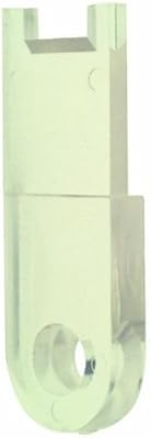

Maybe this? https://www.amazon.co.uk/Cyclaire-Switch-prevent-switches-leaving/dp/B00I3GLL9W/
Thanks for the suggestions, I was looking for something a little prettier though.
