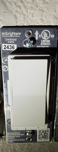

The fingerprint listed for the ZWA4013 is 0063/4944/3533. So, if yours is something else, that would explain it.
This is what shows up—not much
0000-0000 Model name and 0000-0000-0000 Manufacturer means that the pairing to the ST hub has failed. Remove (also Z-Wave exclusion) the device from the ST Hub and pair it again.
So I was finally able to get the switch paired properly (I think), but it still will not control this fan (even though I’ve use the old GE switches in this exact spot for this same fan). It does show up as a fan, finally, and even uses the edge drive you guys told me to download, but the fan itself will not work. The only thing that I can get it to do is spin the fan very slowly. Screenshots attached. Any ideas?
“name”: “ge-fan-scene-v2”,
“label”: “GE Fan 58446”,
“deviceManufacturerCode”: “0063-4944-3533”,
“manufacturerName”: “SmartThingsCommunity”,
“deviceModel”: “4944-3533”,
“executingLocally”: true,
“networkSecurityLevel”: “ZWAVE_S2_AUTHENTICATED”,
“provisioningState”: “NONFUNCTIONAL”,
“manufacturerId”: 99,
“productType”: 18756,
“productId”: 13619,
“fingerprintType”: “ZWAVE_MANUFACTURER”,
“fingerprintId”: “0063/4944/3533”,
“type”: “ZWAVE”,
“mnmn”: “SmartThingsCommunity”,
“ocfDeviceType”: “oic.d.fan”,
“executionContext”: “LOCAL”
Hi, all. I’m curious if anyone has any suggestions, and if not if they know of any resources for working through this kind of issue. I appreciate all the help so far–thanks!
