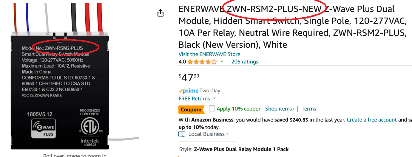

To add to the strangeness, they both seem available for purchase on Amazon. I used (old) and (new) terminology in my previous post, so I’ll continue with that convention.
old: https://www.amazon.com/gp/product/B01G7OD3ME/
new: https://www.amazon.com/gp/product/B07KQMGH7X/
Those are two different devices with different specifications. They aren’t even the same physical size, one is square and one is not. And one has two relays with a max of 4 A per relay, while the other has two relays with a max of 10 amp relay. Oh, and the second one is ETL certified and the first is not.
They also have different, but similar model names.
Zwave plus ZWN-RSM2
ZWN-RSM2-PLUS
The second is a newer generation with better specs. But the older generation is still available from retailers that have inventory in stock. That happens. :man_shrugging:t2:

While it does seem like they have different model numbers, both generations have the same model number in the Amazon title. Both the ZWN-RSM2 and ZWN-RSM2-PLUS are Z-wave Plus devices. Both versions worked fine with the same Groovy driver previously. The difference in device package was obvious (as previously mentioned), though keep in mind that most folks install these in switch boxes behind switches so they are out of sight. Given what appeared to be identical part numbers (though I acknowledge they are not identical) I believed them to be identical from an interface/Z-wave perspective, though it’s now clear that they’re not.

I appreciate that, and I’m sure the people looking at the issue will find it helpful to know that it’s occurring with another model. It’s just that the difference between the two that you described is likely because they are two different models.
Amazon product description titles are notoriously inaccurate for all kinds of reasons, including just translation errors, but even then every character of a model matters, so just the fact that one had -NEW“ at the end does make it different.
In any case, it’s good that you identified the one that is having the issue. It might just be a fingerprint problem. :thinking:
