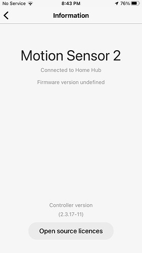

I went into the app and it shows firmware undefined
I went into my account and tried to update there but doesn’t look like it did anything.
Strange. Normally there would be a current version and available version component.

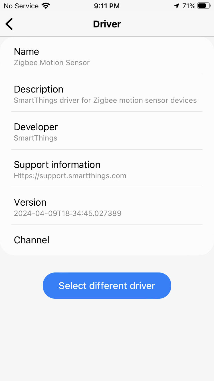

Can you post a picture of the device details from that same page including which driver is being used?
Of course,

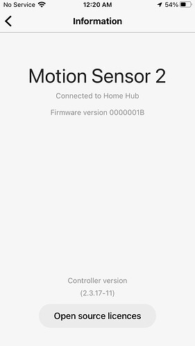

Thanks Bruce. I just check for firmware updates and then clicked update firmware. I saw a blue bar flash across the screen and it looks like it solved the issue.
Manual was set, it looks like
Screenshot 2024-07-13 at 9.26.35 PM
I appreciate your help on a late Saturday night sir, thank you very much!
Glad it helped. I assume the available and installed version now match.
Thanks for that. I didn’t think to check if they were the same. Looks like both match. Thank you for this confirmation.
