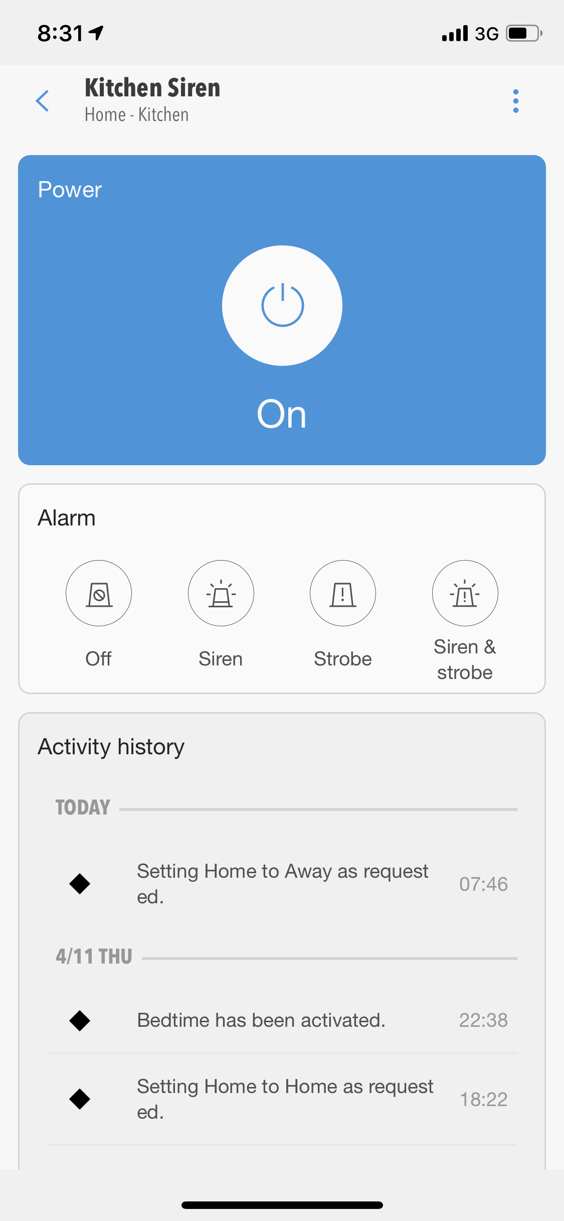

Some devices are not reporting correctly, they are fine in classic app though. For eg look at kitchen Siren icon, shows it ON!! other siren seems fine and shows correct state. Have tried removing and adding. It’s a siren connected through Konnected board. image
