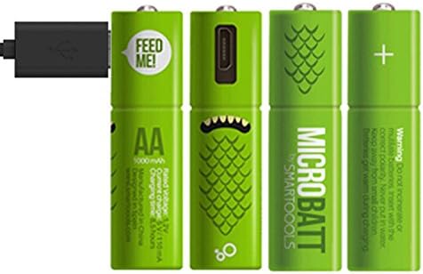

You could use something like this:
It is a AA battery with a micro usb charge port built into it.
