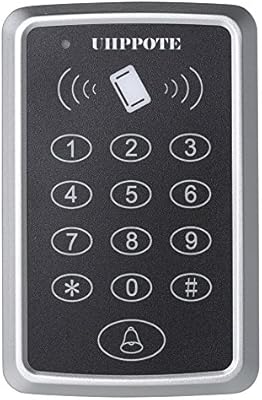

There are ways that you can integrate a door control keypad into ST. Keypads like this one:
work like a relay that is NO or NC based on your application. So, basically, when a correct code is entered, the relay closes for a preset time. You can detect that relay closure with a normal contact sensor (with exposed contacts) like the monoprice contact sensor or a contact sensor device like ST_Anything with a microcontroller board. Now, that is a LOT more complicated than a simple Z-wave device and it doesn’t allow you to modify the users access code remotely. But it is mains powered and weatherproof out of the box. They also other options that read RFID cards/fobs for easier access. Some have settings to require card/fob + code together to open. I’ve been looking at using one to add a keypad outside my garage as well. Might be something worth looking at if your “electronically inclined”.
