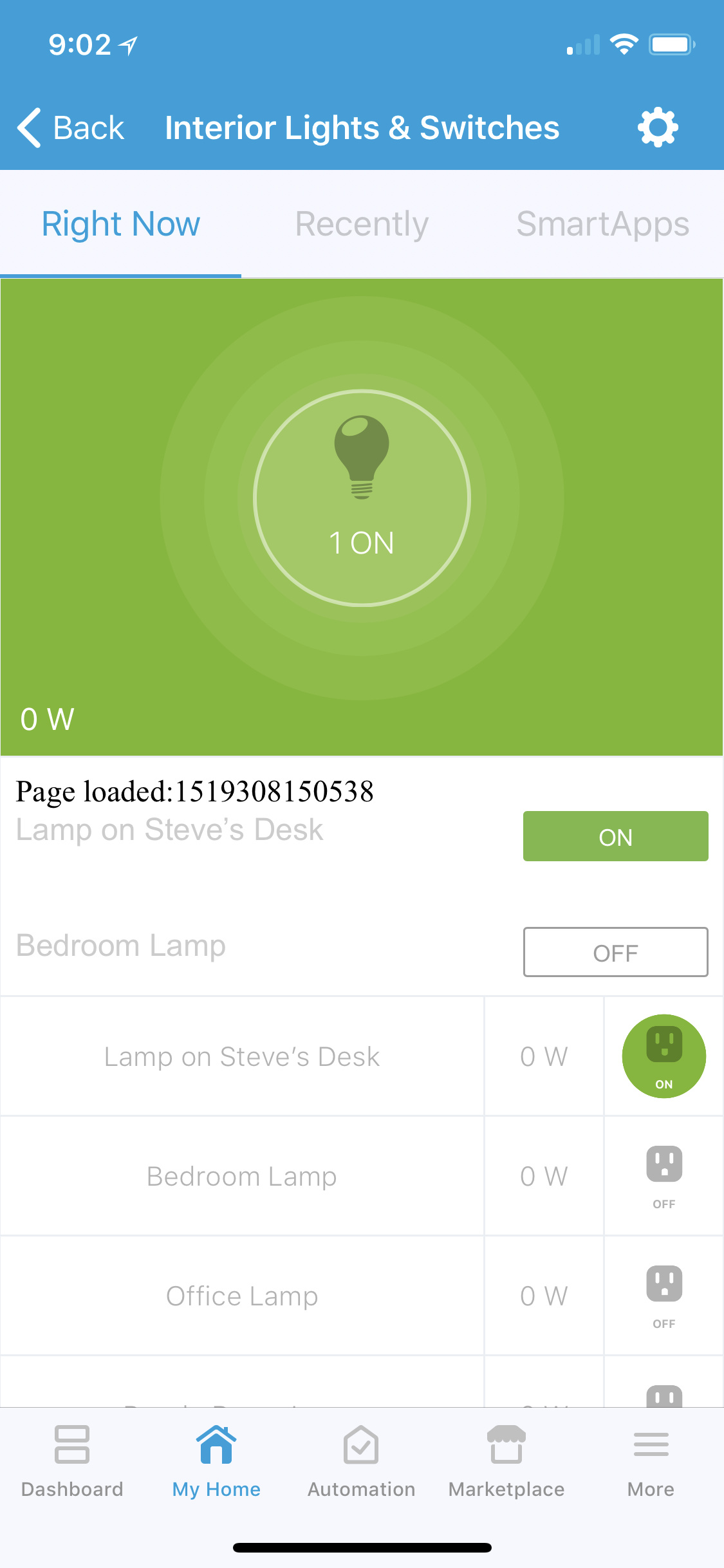

(Steve White) #4
I was playing around with a way to show buttons in an HTML tile as a way to show a list of devices inside within a DTH. I actually got right up to the point where I was going to start making the buttons clickable, but decided to not expend the time trying.
Here’s my code if it helps…

(Matt Behnken) #5
this has so much potential! I realize now that z-index isn’t helpful since the html tile is the “main” . I’ll look at the dev docs for “main” capabilities and save us some time!
